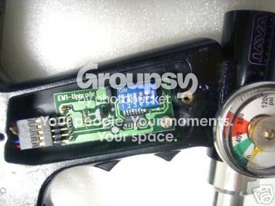

Circut Boards
Boards from other markers, like Bushmasters, will work. Mounting & wire splicing is all that is needed.
You can use a stock Spyder board or Tboard, cut the capacitor off. If you are using the ver-c board, there is an EP jumper you can pull out.
Here is a "red" board that came out in early EM1s. The cap was set at 20bps.
This is the "blue" board. Its cap was at 13bps.

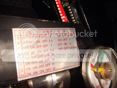

Here is the board settings for the 'Red' Board.
http://i472.photobucket.com/albums/r...ch/reddips.jpg
